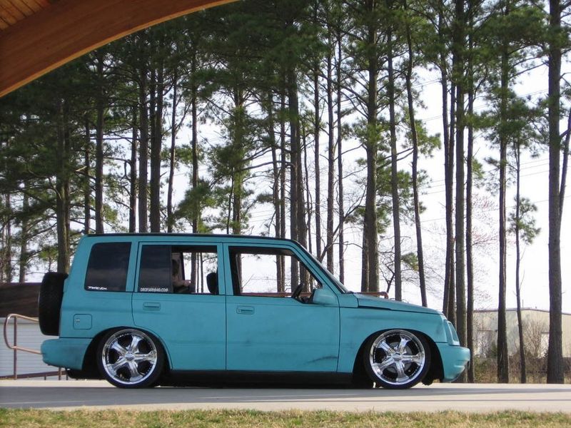

this is sherwin williams primer. its been on there for a little over a year and holding up pretty good.
