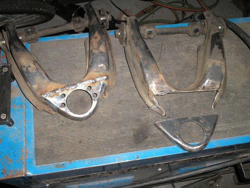

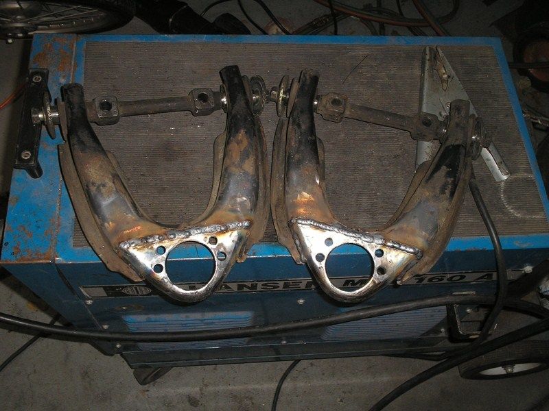

i will be doing some this weekend ill post a pic

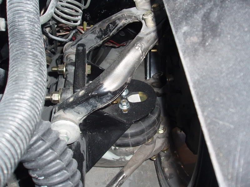

its not the best pic but...i took a 1/4" out and bent the end of the arm down and rewelded it back together, any more then a 1/4" will be too much..hope this helps bro

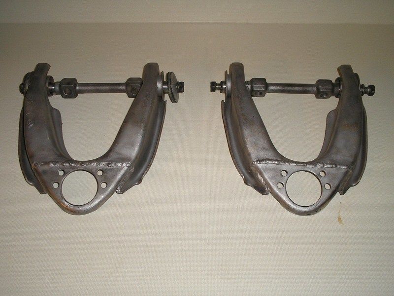

I had to go digging to find these for you. Hope it helps.
