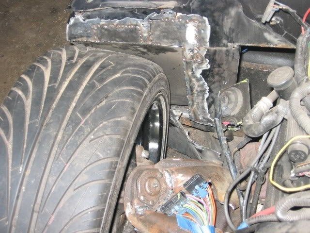

stock upper and lower control cut to lay 20s on a s-10

sorry the wire harness is a bit in the way hopfully gives you a bit of an idea.

He schould atleast get some upper tubular arms. I have a 1st gen and fully laid the knuckle hits the arm. I will be swaping out soon.

I used to cut them back in the day but it fucks your camber up real bad when you change ride height.See when you move a joint like that the arm becomes longer.When you raise it up it cambers in and throughs your tow out causing the truck to jerk around.Kinda scary ride.

those LCAs look scurry

i think ill just tell him to buy some control arm. lol
