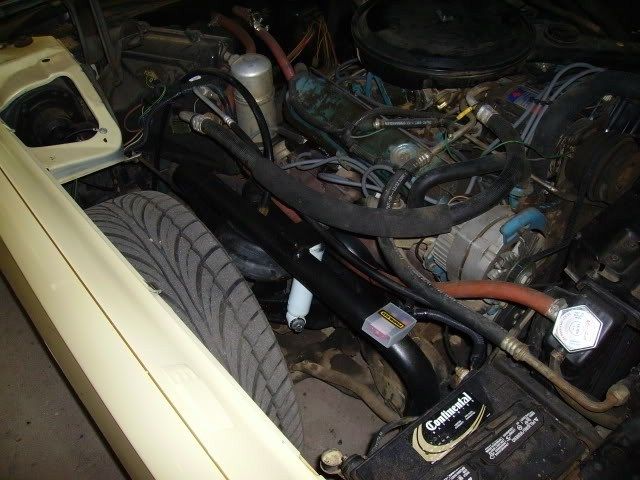

I have been debating a full strut setup front and back with my partner for months now.I think it's a good idea and has few negative side affects.If you pulled a strut spindle of a parts car you could use a airstrut and connect the top with a minor tube frame.The picture posted is a a arm car but is to show you a simple tube mount.Would work the same for a strut unless you wanted something more custom.
