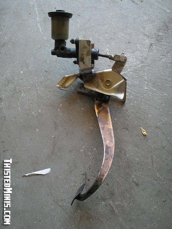

please post pics and how to...relocating the clutch master cylinderim running 19's
TwistedMinis

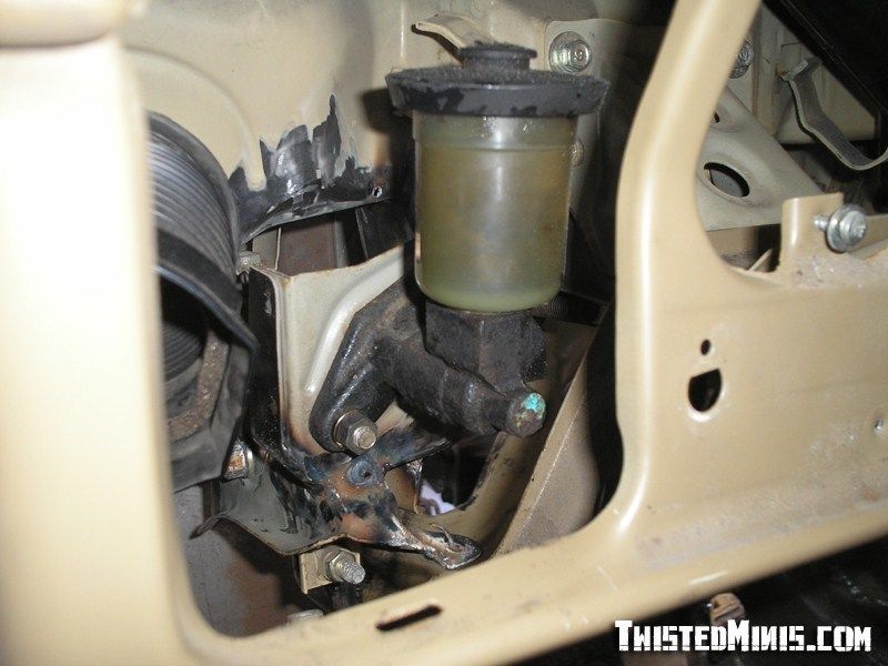

Do this.Then stick it under the dash and brace it. I don't have any pictures of after I braced it, but this is it tacked in place.

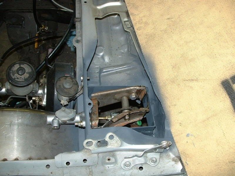

Its not that easy to relocate the master on a 90's yota, Im in the process of doing it now

on the 89-95 its easy to flip it to the inside next to the original point..i dont have any pics but bobby (sadistic iron)has some of his toyotas

sadisticiron
look at my profile and youll see mine. i did a tech on it it should be out in a month or two..
