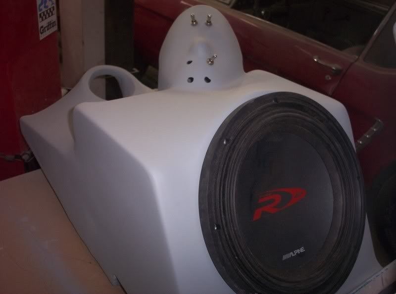

im building a fiberglass dash/centerconsoleand i want to put skulls down the center of the dash starting at the windsheild and going all the way back to the end of the cab on top of the center console
