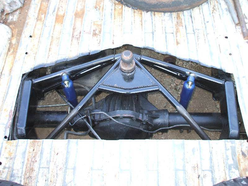

Anyone have any pics of gooseneck hitches on round tube bridges? Im going to put one on my truck but not sure if it will be stout enough to actually pull a trailer....
My bridge is 1 3/4 DOM .120 wall on top of a 8 in notch.

Itll be enough, just be sure to get the ball that has like a 2'' OD shank and uses a pin to keep it in. My bridge is made of 1 1/4'' .25 wall DOM and pulls the wedge just fine.

Yea the ball is a 2 5/16'' ball and instead of having a threaded shank and nut the shank is smooth and has a hole through it for a "cotter pin" You weld a piece of 2'' ID pipe in your bridge and thats the reciever.
If i can get to the shop before it gets dark ill take some pics of it all apart.
