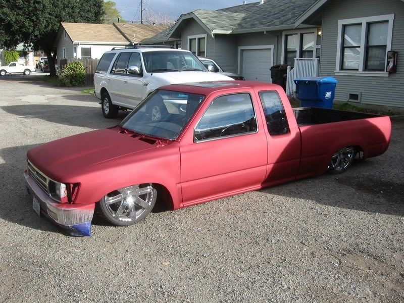

last i checked i have not found any one stage with flatening agent in pearls and metalics for a 1 gallon and all the hardener and reducer (kit) for as cheap as hotrod flatz i just painted my yota with it and i am in love i used carnival red pearl and i payed 170 shipped with the 1 gallon kit and have a shit load left.

too buy the 1 gallon base coat pearl and flat clear and the reducer and hardener you are out so much money and even the one stage is bank so i love hot rod flatz
