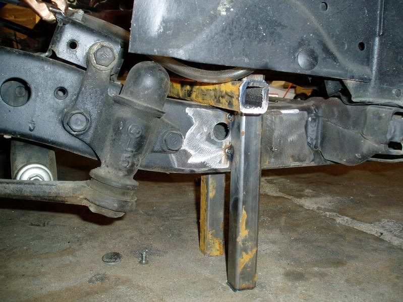

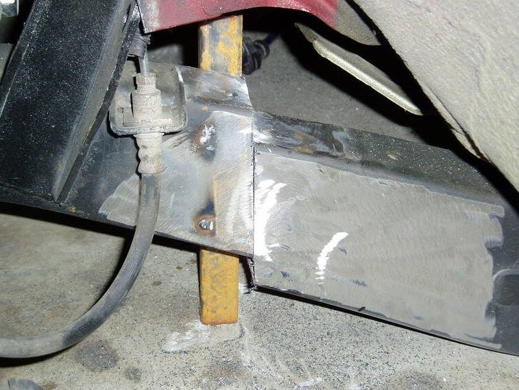

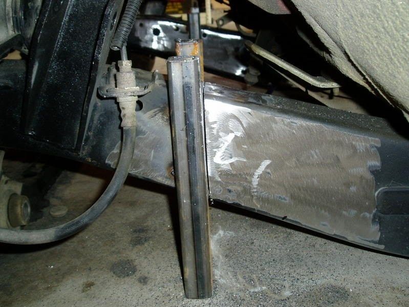

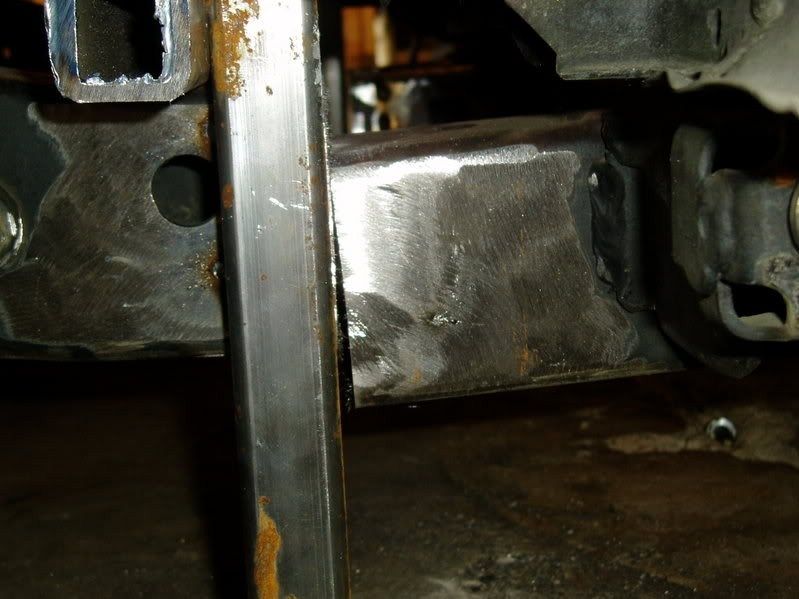

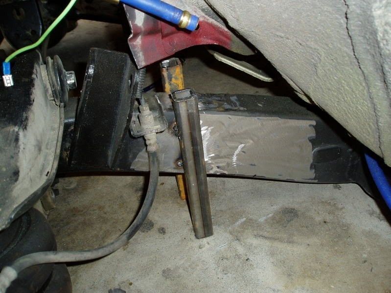

You will have to Z the frame to get it to lay completely. When i did my Z on my old truck the front crossmember was drug down alot so it made for less of a Z.
I have a bunch of pictures somewhere of when i did my Z. There are some people that believe in moving the LCA/UCA mounts on these yotas and sayin its easier. IMO i think Z'n the frame is the easier way to do it. You wont have any steering problems either.

Cut it right at the firewall.
I used the 1x1 tubing as a guide for the sawzal and to also hold the front clip from moving after the cuts. You will have to cut the front by the radiator support just like your doin a bodydrop.
