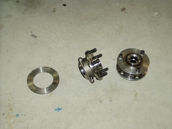

The way the basic set-up would be is, 4wd S-10 front hubs (see pic.) The knuckle would be either left up to you or you could buy one of our knuckles. There would be a drive flange that would bolt in to the hub and accept either 930 CV's or 934 CV's. And those can be modified to have heavy duty cages for more travel and horsepower. The rearend housing will be a TIG welded sheetmetal housing that would be as narrow as possible to allow as much travel as can be "shoehorned" into your particular confines. The flanges for the rearend could be 28, 31, or 35 spline and 930 or 934 CV's as well. There would be an inboard brake option too. The axles would be custom built for your particular application.
