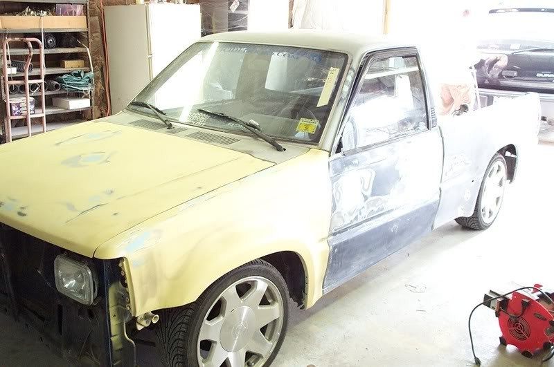

I know the front rims center needs to be machined out, and you need the bulge( or whatever) seat lug nuts.... but what about my stock fenders? Can I keep them? Or do I have to bow out the fenders to tuck the rims. I would like to retain the trucks body lines. Any additional things I need to know will also be useful. Oh yeah... would It be easier to just get different rims with the right offset? Thanks guys, Snoogins
dssur's avatar
dssur
well, there are a few different cadillac rims. I assume you have 2wd sheetmetal?
16" escalade : tuck front and rear, no problems
17" escalade : tuck front, rear you have to pull the bedsides out a bit. If you use a drop spindle it will BARELY tuck front.
18" escalade : BARELY tuck front, rear pull the bedsides out a LOT. Forget bout drop spindles.
20" escalades : no way. Not a chance without narrowing the front control arms and using a narrower rear axle.
