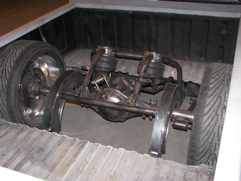

I tig my whole new frame and wouldnt change it for the world.The welds are great it just takes ALOT more time.End result is awsome.I couldnt imagine going back to the mig to do some of this stuff. Here is what i use a Miller CST 280 suitcase welder.
