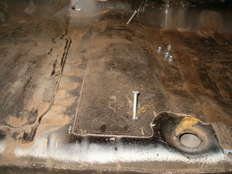

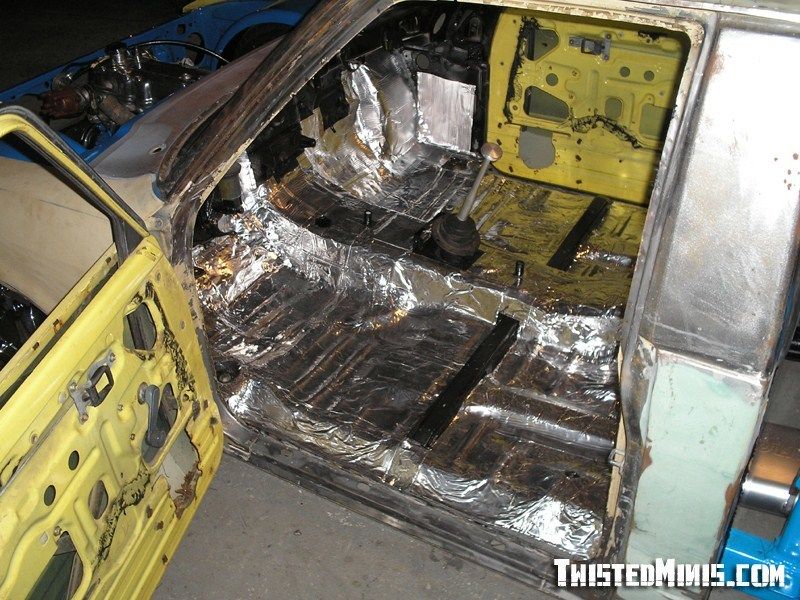

Nope. Finally got my in-laws to watch the kids so I can get some stuff done around the house and voila! Those lips are one long piece that cross the tunnel. I cut them at the tunnel and at the base of the floor. Then, I used a mallet to lay the remaining metal back down and threw some tacks in. I ran a bead on the piece that I left over the tunnel. Thanks guys!

Okay, I put some bolts in there for reference to how far back I'm mounting the seats. The mount can still go forward 10 clicks - about 4" or 5". A buddy of mine sat in the seat where I need it...his reach was about 6" away from the stick, ha hahaha!
