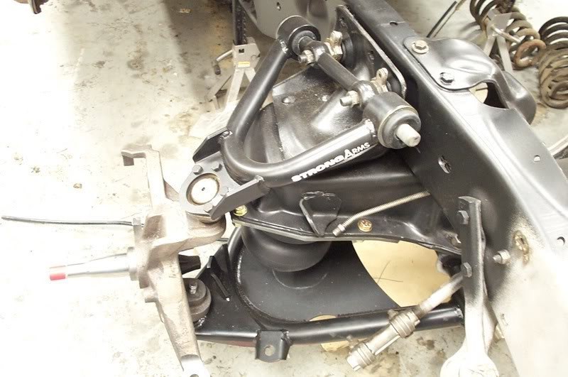

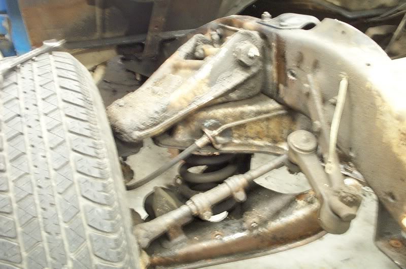

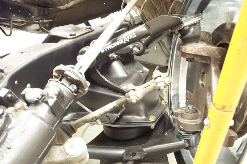

just got ART arms for the 71 suburban were working on. they are awsome.beforeafterthe only problem is the steering is in the way.
if the steering is in the wayheim it and use a smaller diamater dom tubing with a greater wall thickness.
a friend just did it on a 70 c10 because the steering rubbed
