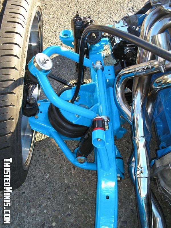

I have RE7s all around. On 18s.
Its capable of wayyy more lift than I need. But it should ride pretty good.
