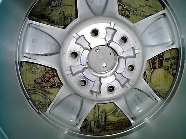

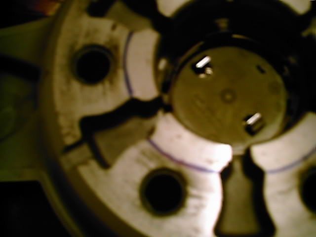

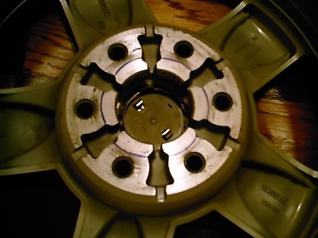

well i need to grind out that much, to the blue line to make theses wheels fit on my hardbody! is this safe if i grind out that much?

You should be fine. I had a machine shop take mine to about that far from the lugs. I'd probably take it to a machine shop though. They made mine a really snug fit, so the entire hub helps support the wheel better.
johnz
i would deff take his advise and go to a machine shop grinder is far from percision
minitrucker04
well that cool that it will work, but sucks that ill have to take it to a machine shop! how much did u get charded seth to get them done?
TwistedMinis's avatar
TwistedMinis
It cost me $150. I had them doo all 4 wheels, so that I could rotate the tires. Would have been $75 for just the two.
twistedsdime's avatar
twistedsdime
As usual Seth is right.
Brill's avatar
Brill
Def take it to a shop... they can balance it and make it even..
If you do it yourself you will end up with vibrations...
