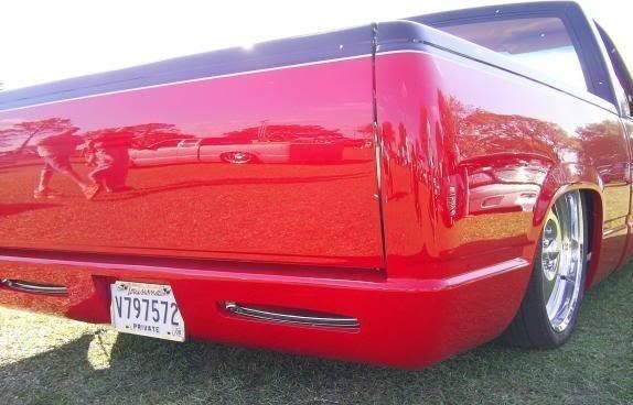

I sanded mine with wet 600,1500,2000 then three stage buff. no reclear but Ive heard if you 400 then reclear it fatens it out alot but I dont think it can get any flater than what I have.
