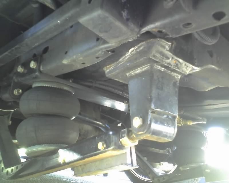

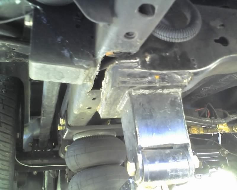

Well I can't say I fixed my problem yet, but I sure got a chance to diagnose. I was right, it was the P.A. but I was wrong about what was causing it to be off. My driver's side lower 4 link bar broke the welds completely through (not off) but through the frame. Well...the welds held, the frame didn't. Here are a couple of pics of it. It will be fixed by Spring Fling...
