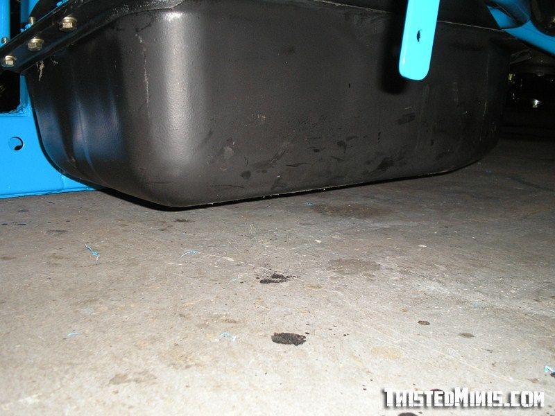

was wondering what to do about my tank draging on the ground im not to fab frendly

Raise it.

Raise it or just get a fuel cell.

you can place the front section on the top of the crossmember and rebolt it. and raise the ass end up to match

i boxed in my frame in the rear with 2x3 and mounted mine in between the frame rails and im going to make a cage for it underneath to protect it but now you have to cut your bed or raise the floor
