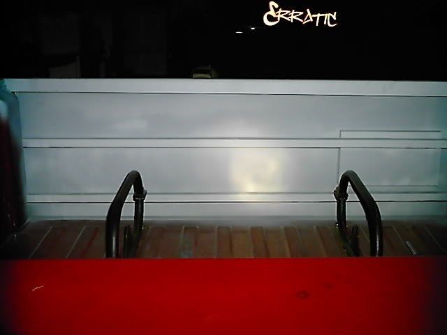

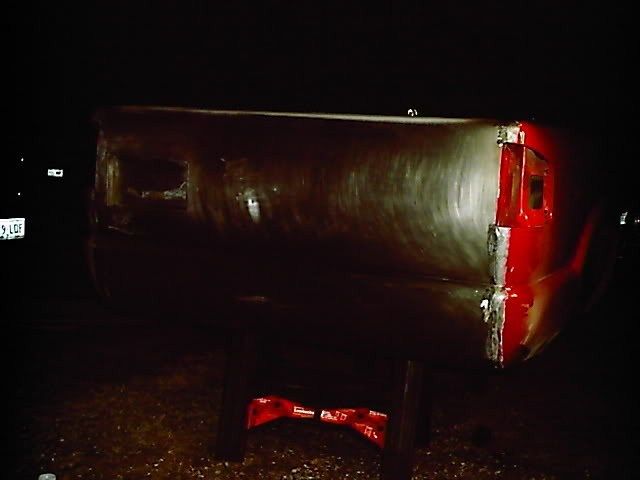

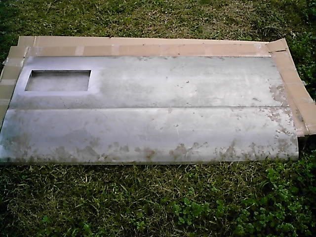

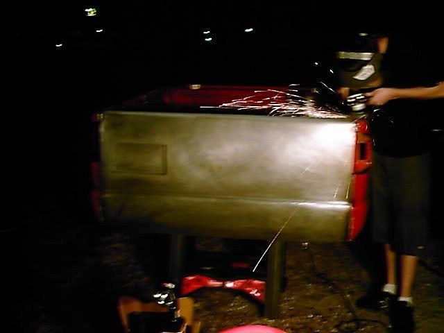

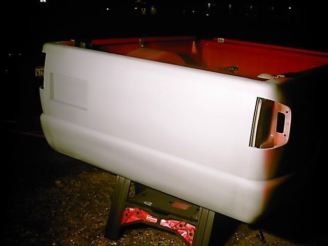

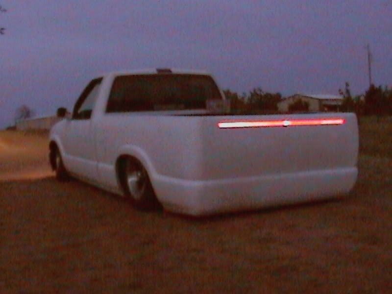

minitrucker04
here are some pic i did of my s-10 2 weeks ago, hope it helps!
