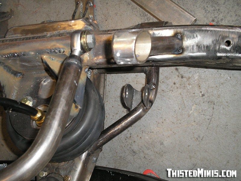

I've got 2600s up front. Channeling the frame a bit is a good idea, or you'll really limit lift by your arms hitting the bag. And keep the bag low.
