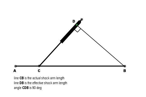

Draw a line 90 deg from the shock angle (even if it ends up past the shock it self) to the inner pivot. The length of that line is the "effective" length. The shock angle will change constantly depending on the amount of travel and starting angle. If you plug the shock points on the mounts in question into this diagram (at full compression) the effective shock length will be zero or maybe even a negative. As the suspension droops out the efective length gets longer.

I would like to see how the shocks get mounted once they are moved.I'm open to any suggestions on that, Max...
We've got a couple different ideas, but none that I'm completely satisfied with/set on doing. Just trying to think of something that's exponentially more effective than the current arrangement, not just marginally so, and not look like a total afterthought/add on to the overall setup design, lol.
