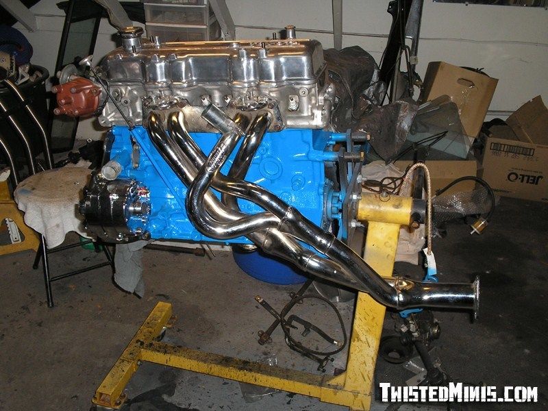

They hang below the frame a little over an inch. I looked at a truck that had one on it. Get a Doug Thorley header. It fits, laying frame, even with a dropped motor. They come nickel plated, and are a Tri-Y design. They look badass, and they're a good deal cheaper. I got mine for under $200 with shipping and tax.

My LC header fit on my yota when it was just layin frame and it still fits now that its body dropped and the front clip Z'ed.
The LC headers come with 2 pieces, the header and a pipe that bolts to the header that holds one of the 02 sensors. If you use both pieces it WILL hang down past the frame. If you use just the header it will NOT hang below the frame.

Well there you go from someone that owns one. I'll shove my foot in my mouth now. Lol.

On a STOCK truck the header will work on the stock exhaust IF you use the second pipe they send you with the header. Since i didnt want my exhaust to go past the cab i had to make something to bolt directly up to the header. The second pipe they send you with the LC header is no good to you unless your truck is bone stock. You can use it for the flanges and 02 sensor bung if you cut it up.

i cut mine all to hell but thats cause i stockfloored mine and my rails were too narrow for the header to fit so i modified it alot.
