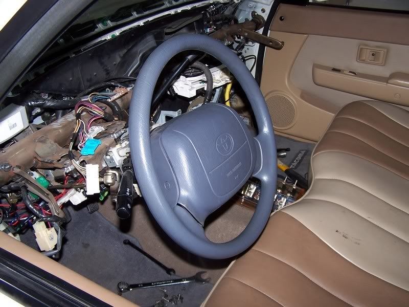

Anyone know any sites on the web where I can find out how to take the dash out without fing it up??
chumpchange's avatar
chumpchange
no sights but it is very easy. a hand ful of screw and a handful of bolts unplug your emergency flasher module and clock and you are done.
dragnlow's avatar
dragnlow
I'm going to give it hell here in a few. Wish me luck!
e10pvmt's avatar
e10pvmt

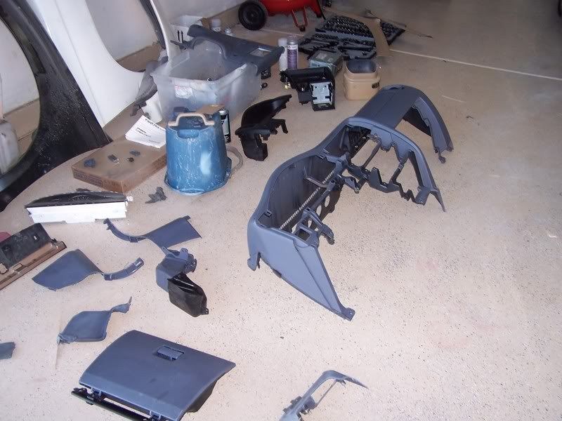

its easy as hell...took me 1 hour start to gutted dash, seat carpet and all in my reg cab taco....it was the easiest gutting i have had to do....
sittin_so_low
yea, not to bad, just alot of screws and whatnot. i did mine within 2 hrs, everything i got out. start with the center part,( the radio, ac/heat ect) the cluster, pass. side air bag stays, the dash comes out over it, but the top cover for it comes with the dash. pull the pillars out too. might as well get everything.theres only a few screws that are hard to get to, like around te pass. side air bag. are you going to smooth it out? it took me a good month to smooth mine, just got done ( well %85)

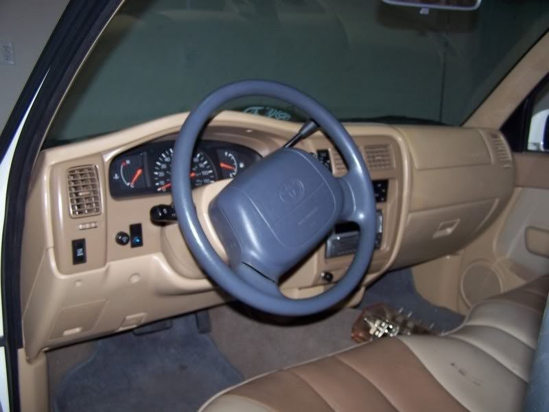

just going to color match it to the rest of the interior. no smoothing just simple and clean. thanks for all the info!
inomrthenudo's avatar
inomrthenudo
dragnlow's avatar
dragnlow

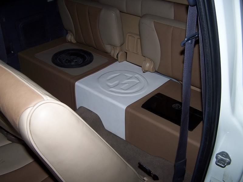

Here is my new box from Xtreme Audio in Murrieta
and the completed dash
fatman's avatar
fatman
nice choice in amps and subs im running all memphis
