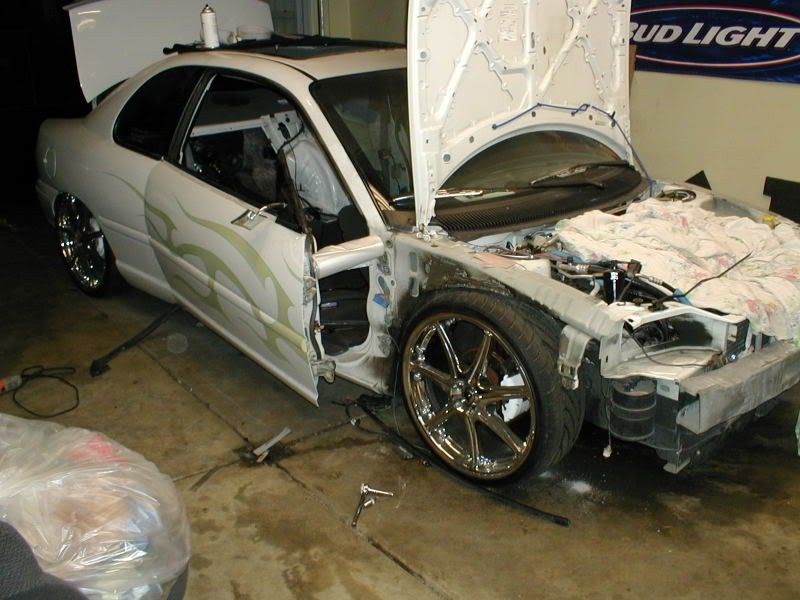

you deffinentally want the buckets as far out on the edge as possible. the further it is out towards the edge, the better chance you have of letting the door swing out and clear its own panel.
see how this one is way out on the edge, about as far as he can get, and still have room to get a good weld.
and then with the hinges extended out to make sure they can swing.
