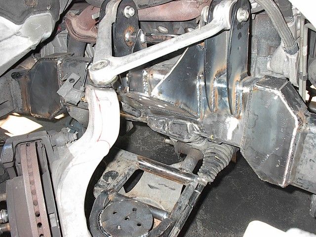

You have any pictures?

http://i5.photobucket.com/albums/y178/centralcustoms/DODGE4.jpg

Those pics are of a ram if I'm not mistaken. In fact I think I was looking at it at fall fest. Nice truck. Yea you may need to reangle the balljoint or find a balljoint with more travel then the factory. If I can help with anything else man just let me know.

The picture from above...
