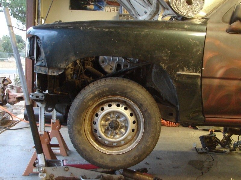

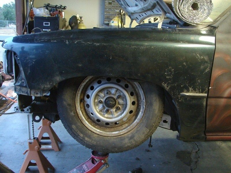

sadisticiron's avatar
sadisticiron
sadisticiron
lifted and layed out completely for an 18 you can go up to a 22 if you wanted to
HotRodDime's avatar
HotRodDime
damn! Now that's some lift
Did you really find it to be more work seth
