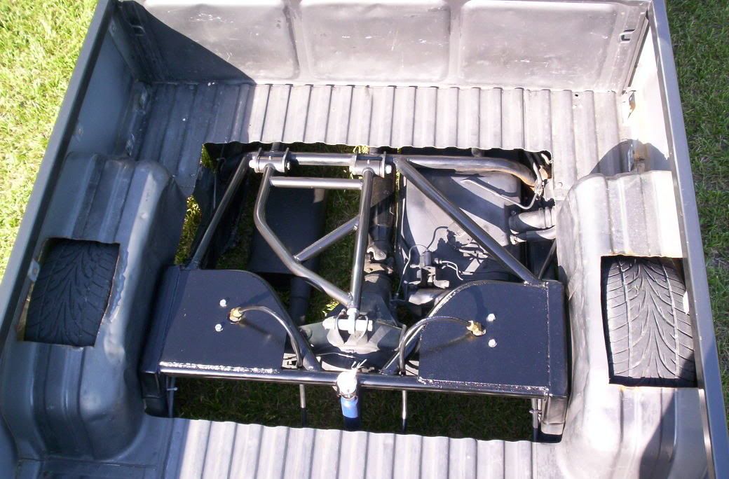

if your up to different setups other than a fourlink, i would recommend a three link setup (aka wishbone). its a basic and reliable setup that allows you to keep your gas tank in the stock location and not have to use a pan hard bar. here is a pic of my set up in the back of my toyota. you can do it basically the same way with your mazda.
[IMG] http://i70.photobucket.com/albums/i95/holcombe347/100_0621.jpg
