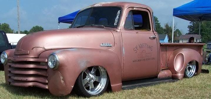

Well i may end up doing that cause i would like to change to a forward 4 link. Just want to keep it kinda simple on this one cause it is my every dayer right now. When i started on it i was going to make it bad ass now i just want to drive it. and work on my 53.

the 53 is sweet ..arnt ur links adjustable if they are adjust them a lil

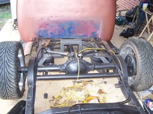

Heres my idea on fixing the problem.All forward links, gas tank is 2" above the bottom of the frame.

That is cool as hell but my stock gas tank runs under the cab thats why i was thinking about the regular cab gas tank.Thanks on the props on the 53.

You could still do something similar. Or like you said, swap a standard cab tank in.

Cool thanks for the pic that helped out alot!!
