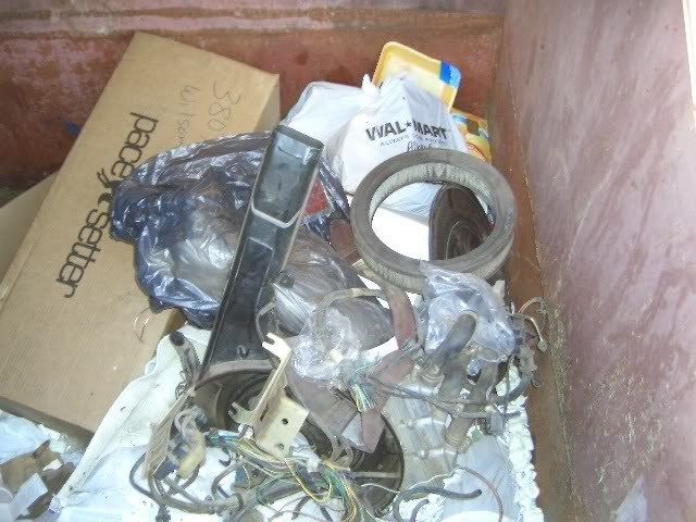

damn air injection tubes are pesky uncapped.
BROOM HANDLE LOL
Originally posted by KAOSS
And since the ecu is gone, do I need an 02 sensor any more?
nope. not unless you plan to use an A/F meter.

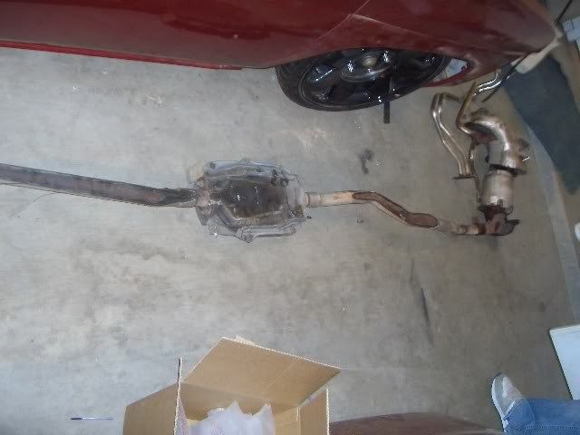

It's 4:54 am. just finished putting the header on.

It was well worth it. going to the exauhst shop next.
