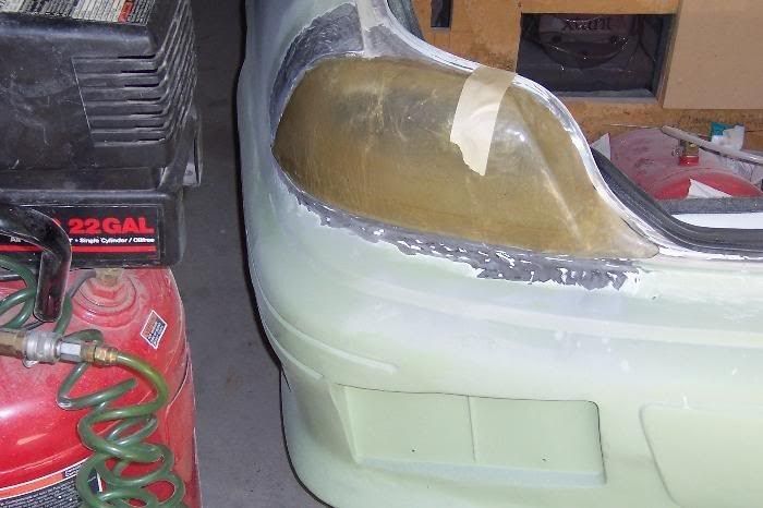

u can fiberglass some. Use your stock tails as a mold. Its incredably easy, metal ones would be sweet too. Guess it depends what u want. Metal ones can take some time to fabricate but well worth it. I glassed mine took me about a day to glass them, mold them in and straighten them out.
Metal is somethin I would have done but I am not a metal perfectionist and my tailights would be a bitch to do.heres a pic from a lil over a yr back when i did mine. If someone puts down fiberglasses lights and tells you they will crack the moment u hit the road they r way wrong. I drive my car all them time ive even grabbed my car by one of the glassed tailights and tried shaking the crap out of it. They are not moving and r very strong. I think that most of the people that have problems with them did something wrong.I used panel bond to mold them in. then on part of the light I had used Evercoat reinforced compound filler basically its like everglass mixed with fiberglass strands. It worked great.

I guarantee u on a hot ass day u can see line where tail filler meets metal though man. Metal to Metal welded solid is only way to do it right..............
That may be true, but I havent see it and thier are still tons of people that do it. But hay I guess do wut u need to man just laying another option out thier.
