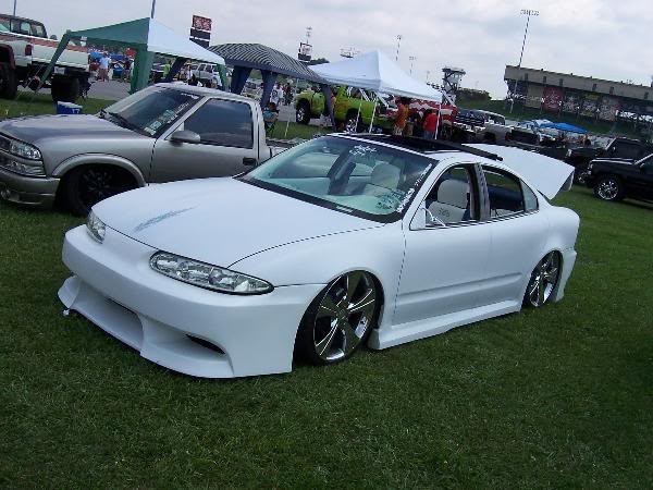

well juice will get you lower. But air struts r easier to install and are improving. Air lift makes a kick ass air strut that sits lower than most others. dunno who said aim. Aim sucks balls those struts are peices of fucking shit ina can.Heres my friend Richies alero it sits on 20's with air lift struts.
