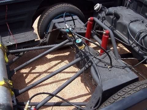

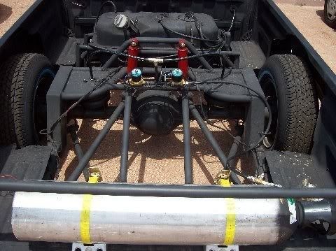

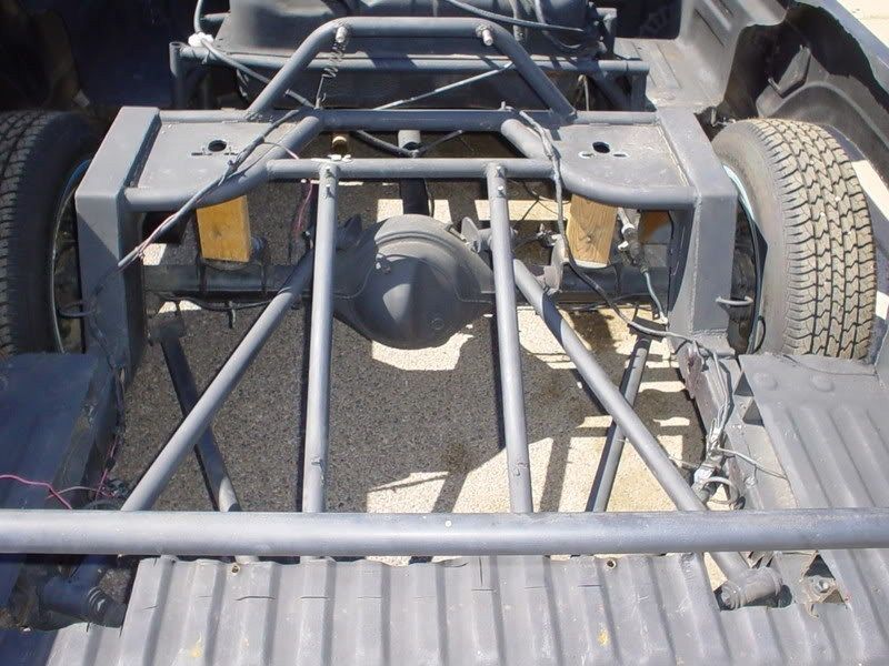

looks okay except the reverse 4 link, which is confusing because the gas tank is mounted in the bed....
Its also double triangluated and the rear mounts all look to be on the same plane, bet it binds like crazy.
Flip that 4 link forward and you'll be golden! Just buy new tabs and read through some other posts about how to set it up.

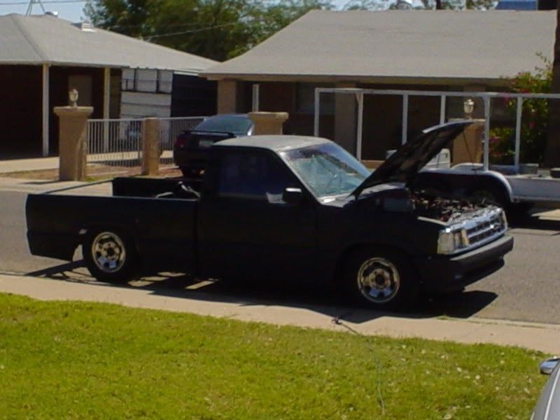

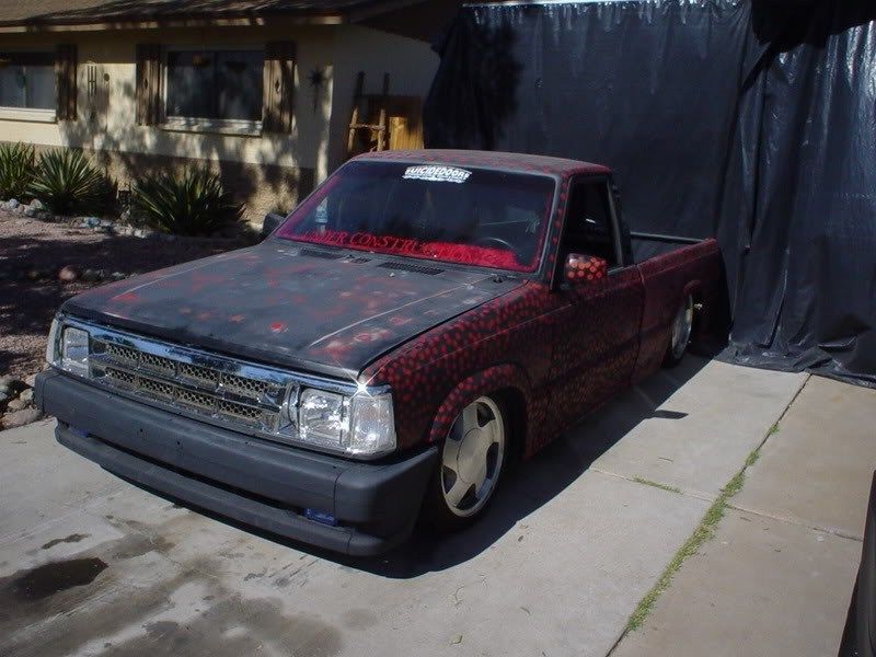

Alrighty, I picked my truck up on saturday and its a basket case but it runs and drives. The owner said the engine had a rod nock but it sounds like the pilot bearing in the tranny to me. Anyways, the guy took 200 bucks off the truck originally if I put the bags and stuff back in because he took it all apart to part out. I ended up getting the truck for 420 dollars. Ill post some pics of the truck when it got to my house and then now.
My compressor is a Viair 500 and it works good but it squeals alot. Is there a way to check the oil level?

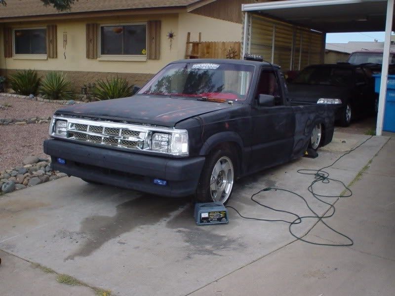

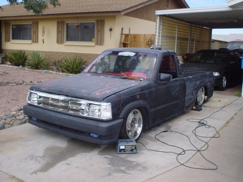

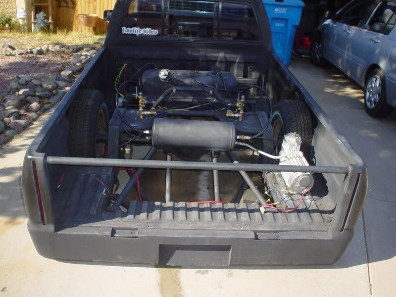

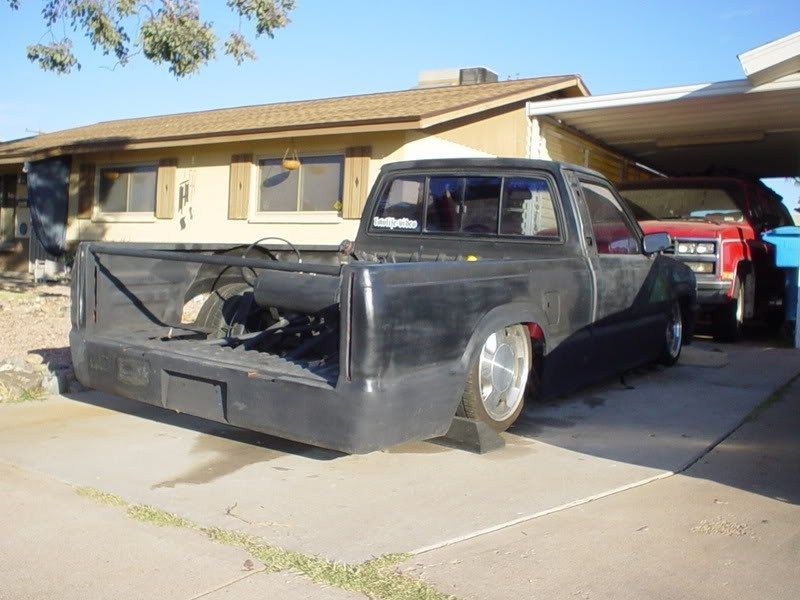

Well it may not look like much but here are pics of my 86 Mazda b2600. Right now it is only bagged in the rear but with my valve setup and only 100 psi it will hop about 6 inches off the ground. I will be bagging the front this weekend if I can find a bracket kit local to me. The interior is completly stripped so I will be attempting a body drop, with help from a experienced friend ofcourse.

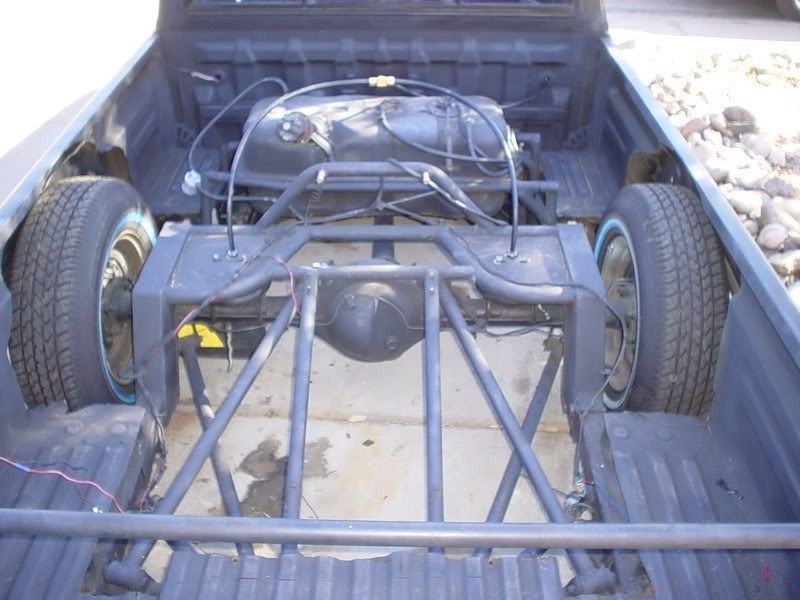

What it looked like when I brought it home:I hooked up the rear bags and ran some line, I didnt have my compressor mounted or my valves but I wanted to play with the truck anyways.

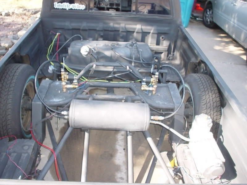

Now I have my valves hooked up and my compressor plumbed so here is the current setup:
What do you all think??

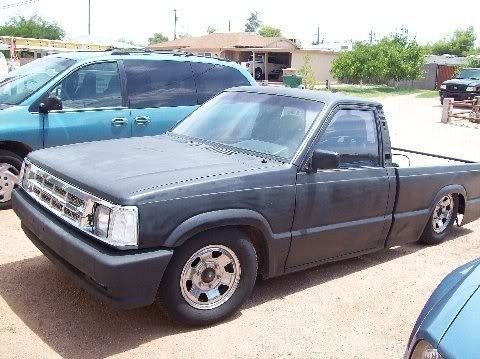

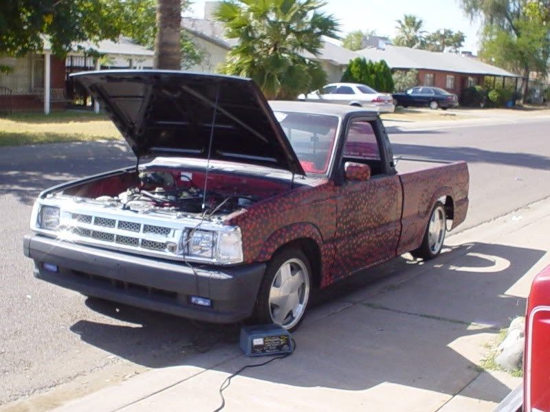

Well the front is bagged and I have different wheels on the truck. Just figured Id post up some pics of the progress.
A baby drag down my street. Here you can see my sweet fuzzy red interior.

I still need a skin for hte rear and a air cleaner assembly so that I have some hope of passing emissions but its comming along nicely, I think anyways.
