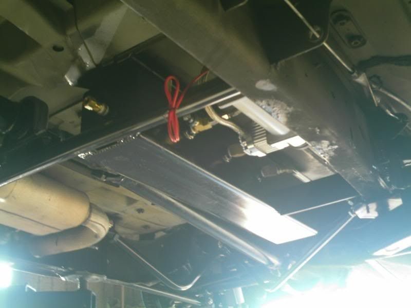

Or you can make one,This is about 5gal.

I don't think square or rectangular tanks are good high pressure. By design they aren't are strong as a cylinder style tanks. The flats ends and the seems are weaker. I'm an engineering student and have had this discussion a few times, but that my opinion (I guess)
