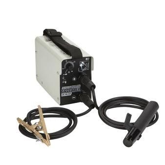

just got this sweet puppy in, gonna build a bulldozer box with it:
