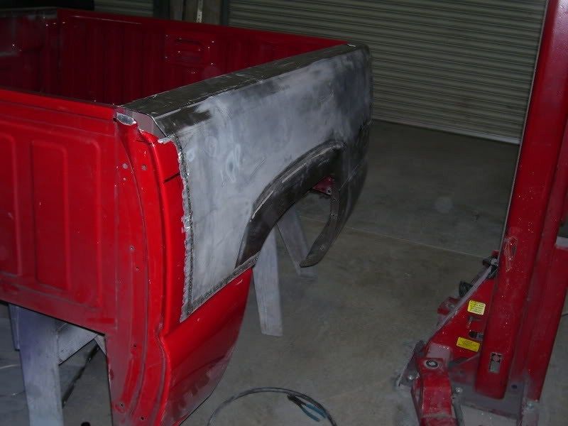

Do i need more tacks or is this enough?
redcrew's avatar
redcrew
tack all the way so it looks like one continuose weld no pin holes id will hold up better that way
redcrew's avatar
redcrew
like this
jsnpdy22
Ok ill tack somemore tomorrow. Thanks for the info.
Rob Clayhill's avatar
Rob Clayhill
yeah that looks good.
i always completely tack as well, alot less chance of anything cracking out.
redcrew's avatar
redcrew
go slow all this took at least asaturday
