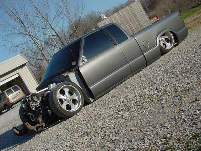

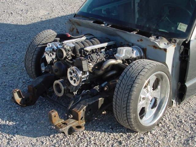

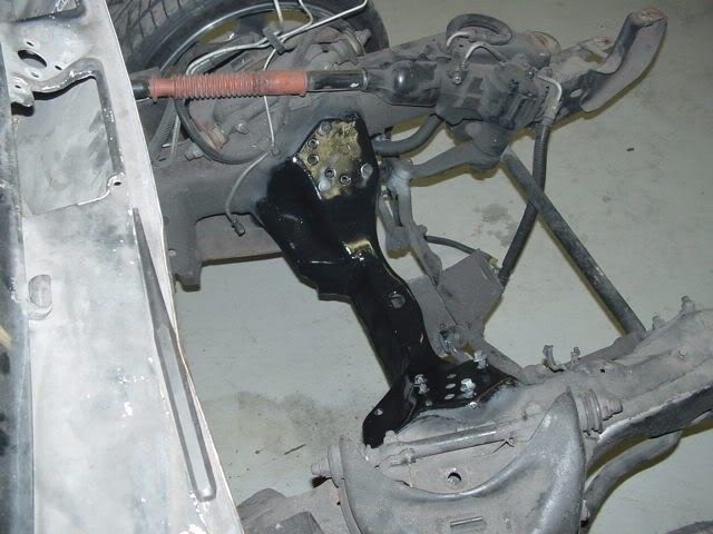

Here are a few pics of mine. Had to notch the crossmember.Used a truck oil pan that was notched, shorted, and drain was relocated. O and rerouted the pickup tube. All the acessories are from Street & Performace. I'm in the process of putting in a new floor and firewall to clear the 1 7/8" longtube headers. Hit me up if you need anymore info!
