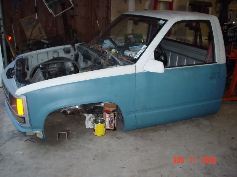

can you buy a white primer and tint it with a blue? How would you go about doing this? i am doing alot of my bodywork on my truck right now and just have some grey, but I want a little color befor I get ready for real paint.
somoene told me to get some white primer and add some regular paint to it to get the color I was looking for. Is this true. I kind of want a baby blue, so i was figuring getting the white and just add some regular blue to it, to make it like a baby blue.

yea just buy'n sum white and put'n a lil blue base in it will work. or u could just buy u some sherwin willams specrta prime it comes in baby blue and many other colors. thats the stuff i used to paint my truck and i love the stuff.

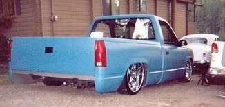

yea sherwin willams makes it but hell its cheaper 2 make ur own wth regular primer!! mine we took urathane primer and mixed blue wth it till till we like it!! got a gallon wth hardener and every thing 4 life 80 bucks and the sw stuff wuz like 130
