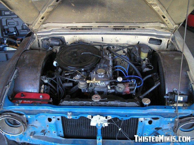

Charcoal canister is under the battery tray. I split up the vaccuum line block to make them smaller, bunch of electrical stuff is on the outside of the core support, inside the fender.

i think theres pics in my profile
