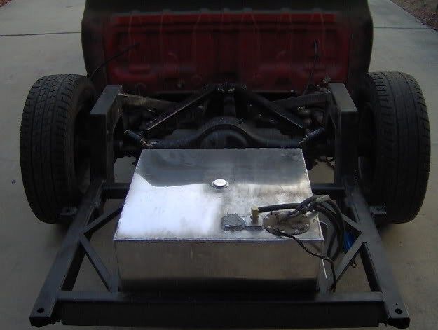

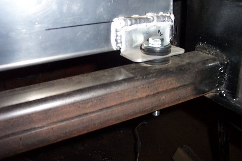

yea the 4x4 guys know this all too well they crack alot of them. when i got mine in all of the mounting tabs were broken so i ripped them off and made some new ones out of 1/8" thick aluminum angle and welded new mounts. I then isolated it from the mounting rack with a 1/2"thick 3/4" diameter grommit top and bottom of the mounting tab.
this is a good pic, i also used 7/16" grade 5 hardware.

doing it this way takes all the stress off of the welds on the side because they nolonger have to deal with the mounting bracket

i didnt know if you got to see it at mmb, i did see you loose about $30 worth in gas. you could also make it extra diesel and weld up some heavy new mounts like mine. i think i got the metal at home depot for like $5
