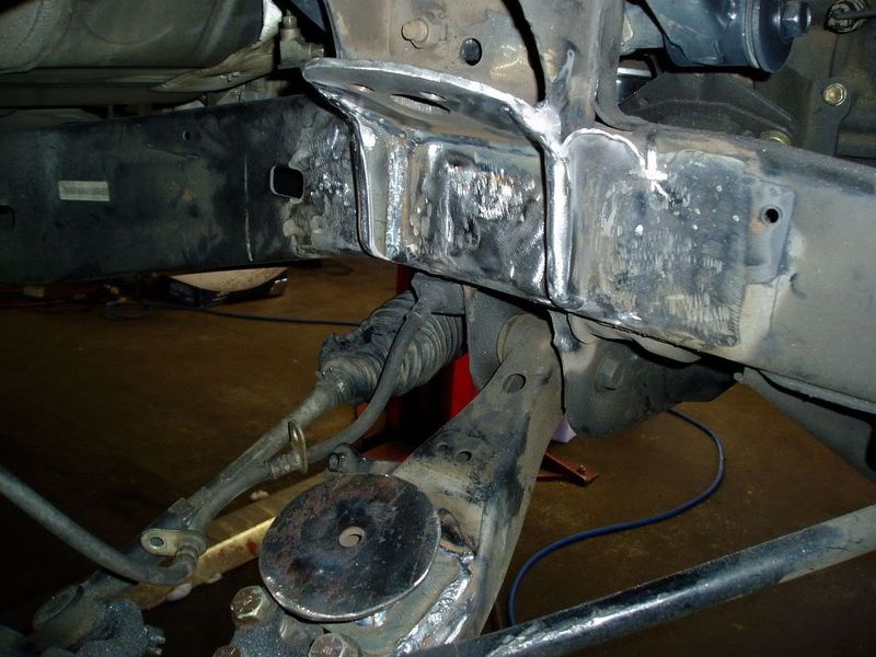

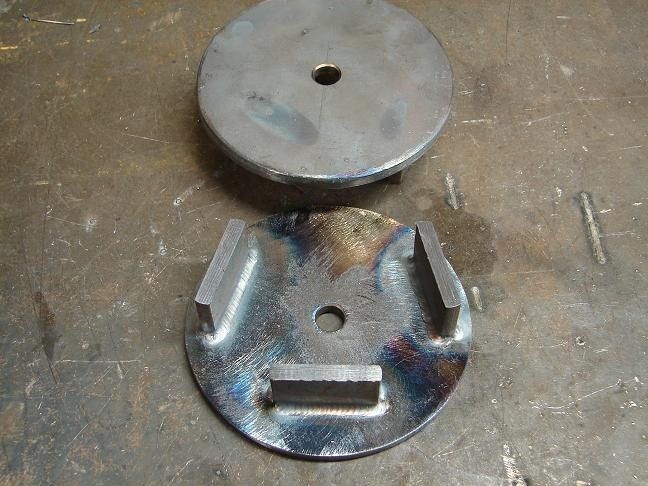

CAN EITHER USE TOP CUPS IN THE SPRING POCKET OR WELD A TORSION BAR STYLE BRACKET TO THE SIDE OF THE FRAME.ID SAY THE BRACKET IS A LIL MORE ADJUSTABLE THAN A CUP BECAUSE YOU CAN SET THE BRACKET WHERE YOU WANT BEFORE WELDING IT IN.

Heres a taco me and a buddy did.

time1's avatar
time1
Balljoints are flipped on that one and the guy daily drives it. We did that about 2 years ago.

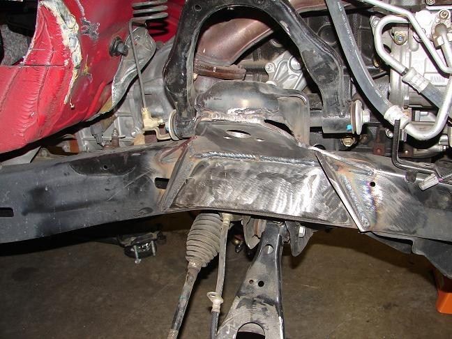

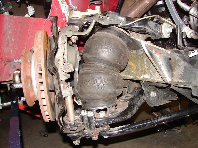

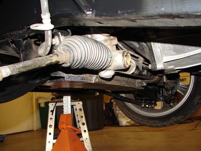

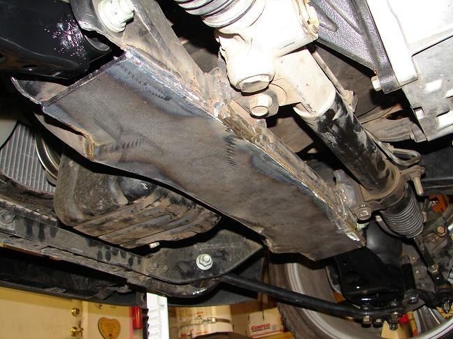

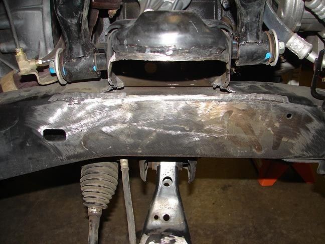

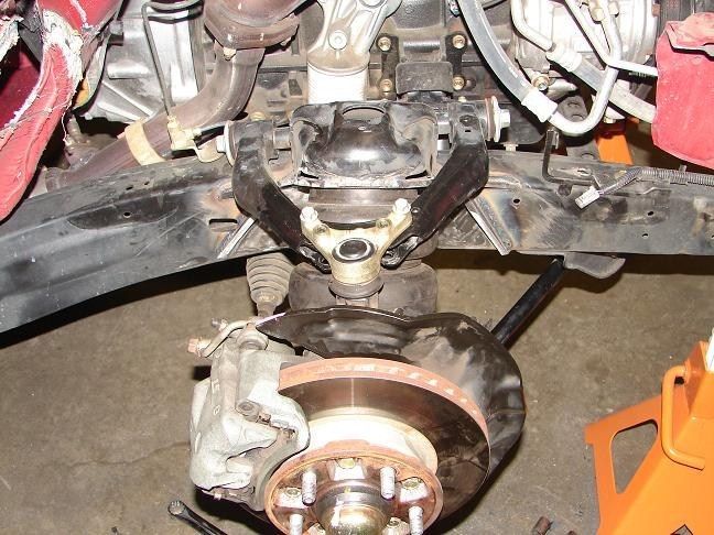

Anyone have any more pics of flippin the ball joints and a 7in. bag??
sadisticiron's avatar
sadisticiron
heres pics of all stock components with balljoints not flipped the uppers were also put back in th eupper arm.
dragnbody's avatar
dragnbody
So it lays out on all stock components?
