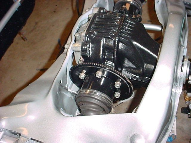

We had to take the stock diff completely apart, and press off that geared ring, and then another member of our club made the adapter plate, tacked it on and turned it on a lathe to balance it out. The sensor is mounted on the underside, it's a bit tweaked so it doesn't read but it will be an easy fix once i get off my ass and do it.
