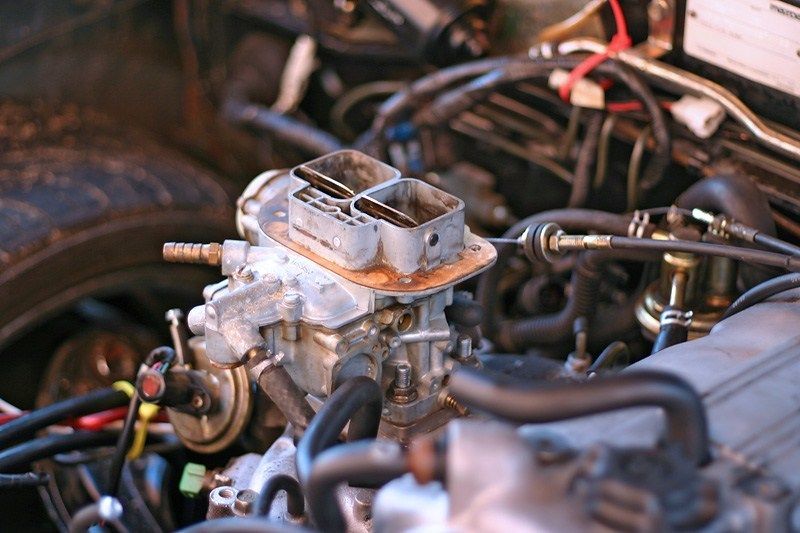

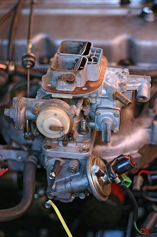

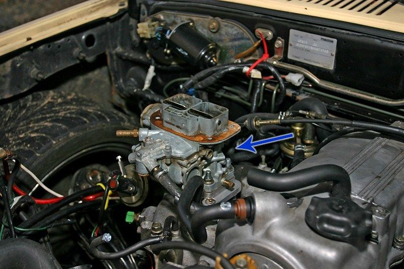

Don't know if this helps ya any but here are some pics I snapped tonight. Double checked and it does say 38 DGAS.
The blue arrow points to the big vacuum line that has a ton of suction. It has a plug over it.

sorry, I need a better picture. That picture doesnt show anything but the plug.
If you look at this picture of a 38 DGES, there is nothing even on the casting on that side.
Are you certain you are not mistaking the big vacuum line for the PCV or the brake booster that comes off the MANIFOLD and not the carb? They are also around that area.

oh and that barbed brass fitting is a fuel return from the float bowl, not a vacuum line.

You're kidding right? Pictures are about as clear as they get.
Under the vacuum plug that is pointed out with a big blue arrow, is another barbed brass fitting identical to the one that you claim is the fuel return. It is coming off the carb and not the manifold where the brake booster is connected.
I'm not sure what kind of pictures you want to help tell me what these mystery "vacuum" lines are. I'm not exactly entertained by the notion of disassembling the carb to take pics of 2 fittings that are pretty obvious in the above pics.
