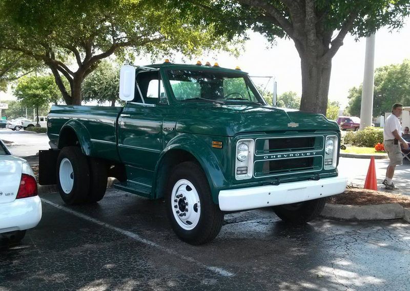

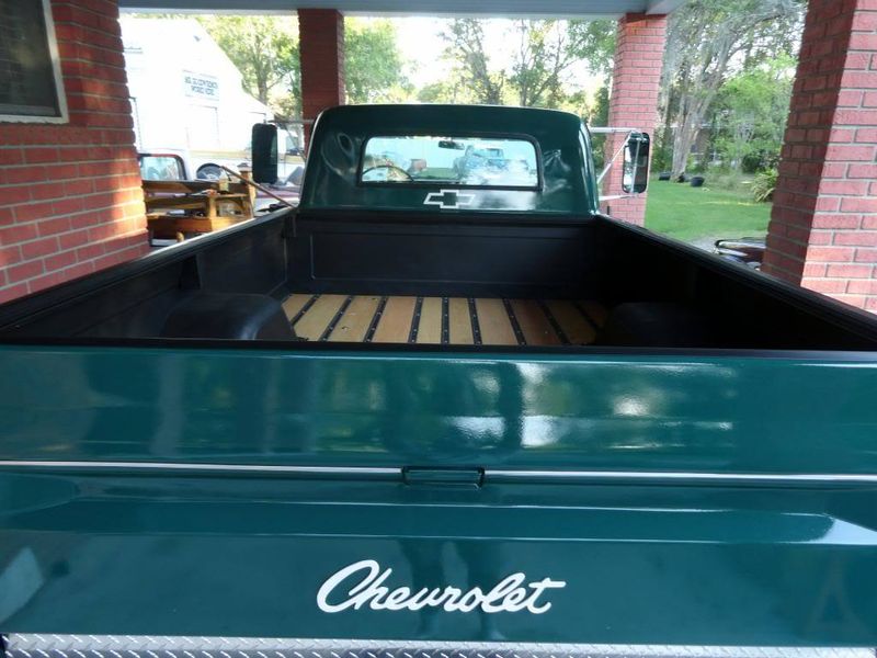

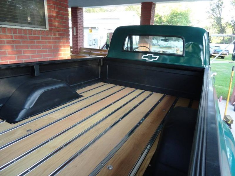

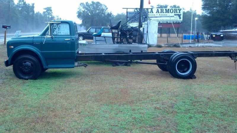

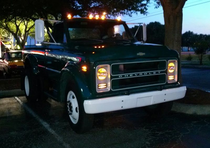

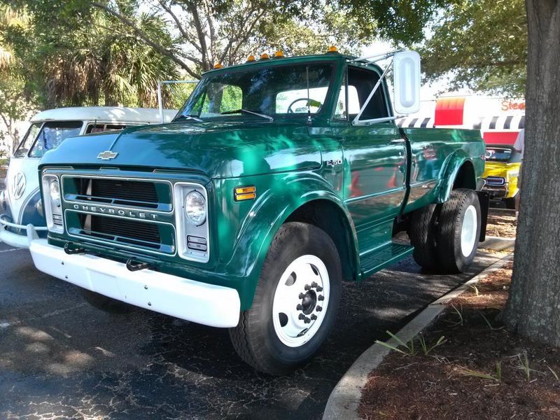

I seem to like 67-72 Chevy dually's and have done a 72 C50 and now working on a 67 C50. I want to change the dually rear on my 67 and go later model hardware with disk brakes. Anyone know when rear disks started on dually Chevy's? Here are a few pic's of the 72 C50. I cut the frame down and added a standard pickup wood bed.
When I first got the truck, 218" wheelbase.
