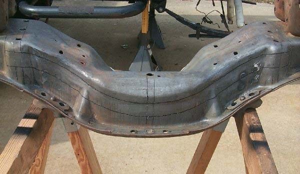

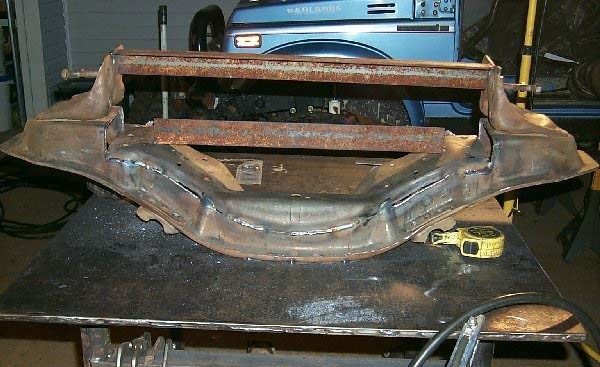

To lay one of these out, if you section the crossmember 1.5" you can lay flat on 20s, and it does not move the motor up. For 22s you'd have to Z it a little more, but the motor wouldnt be raised up so much.
