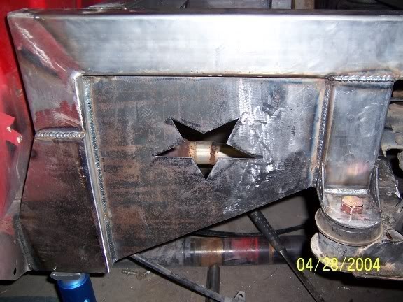

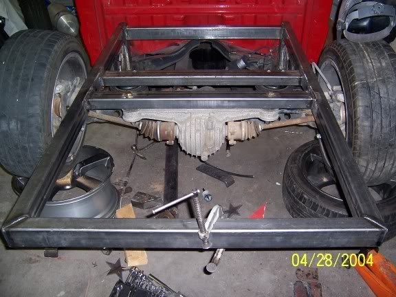

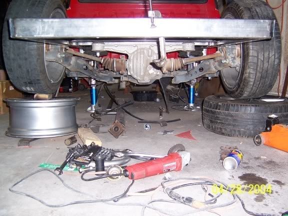

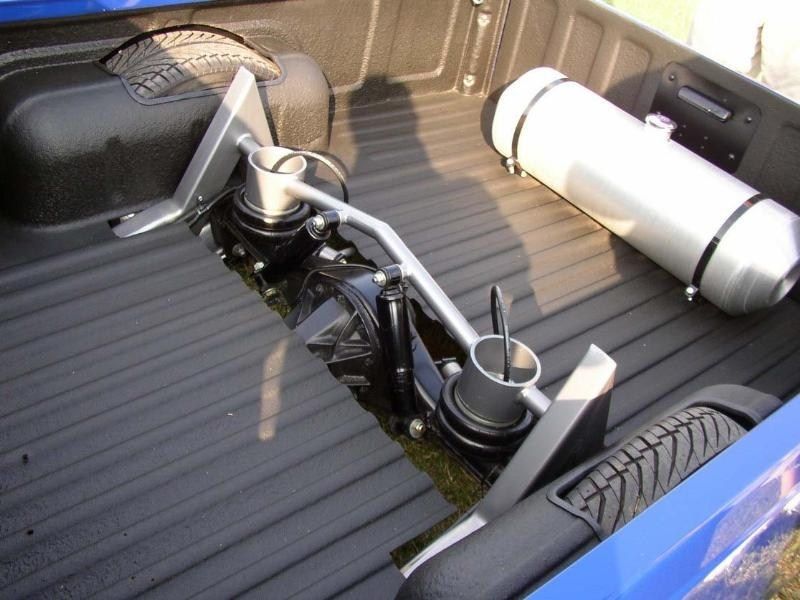

Heres mine it not done yet. Back halved with 2x3 and Rx-7 Irs. Its pretty simple cause its covered by the bedHosting">
Looks pretty good, but you might want to put some big ass washers under the bottoms of the irs mounts, wouldn't want the bushings to fall out.
They should be bigger than the outside of the bushings.

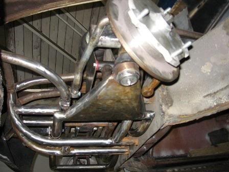

I'm pretty proud of mine. It's nothing spectacular, but I like it. Not bad for my first shot at 17 I think.

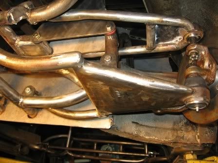

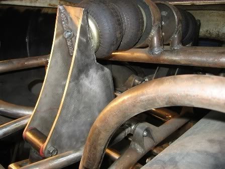

streetsweeper1
Sure you've all seen it before. Im currently building the rear.
