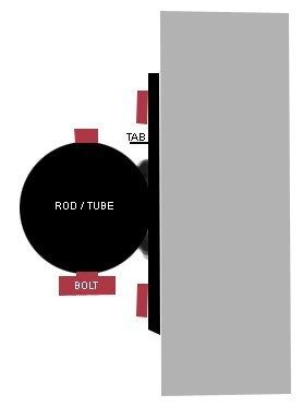

yea i would drag em is it a good fit into the other tube or is it a lil sloppy fit? cuz i was think ing about them making a noise like banging inside the tube u kno whut i mean i hate rattle i spent this much time 4 my shit not 3 ratle aint stopping now
yeah, its a good fit inside the tube, but i had to use a bolt that was 1/16" smaller than the holes so it will move up and down a little less than 1/16". if i can get the holes exactly centered i think i can use a bolt the same size as the holes so there will be no play in it.
HIonPsI
just wondering but how would you mount that while keeping access to the adjustable holes
luv2sprk
the plan was to weld it flat on the side of the frame with the bottom of the tube even with the bottom of the frame, with the bolt holes parallel to the frame. or, i could weld it the same way to a plate with holes in it, then bolt the plate to the side of the frame.
badfish57's avatar
badfish57
Edited: 4/29/2006 10:25:20 PM by badfish57
yeah a couple of peices of strap for tabs top and bottom or even a plate so you could weld it or bolt it to the frame and your golden. obviously thats a top few, but you prolly figured that out..lol
LAYEDOUT69
Price and dimensions ? The idea above sounds best to me.
luv2sprk
yes, thanks, thats what i was thinkin, so, who wants a pair for 80 bucks?
