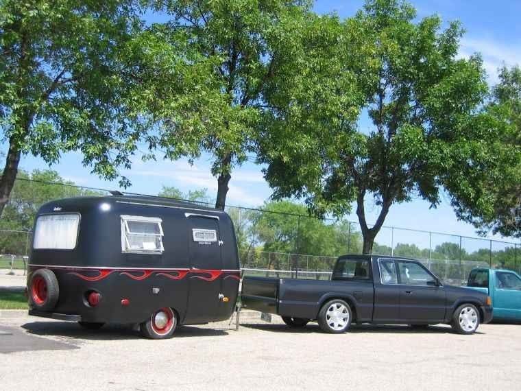

aight, there is 1.85" of overall diameter diff b/t the stockies and the eskies. therefore when you put those on, therell be an extra .925" of fender gap. so youll have about 6" of fender gap with the new wheels unmodded suspension.
olskoolpup
it says in this guys profile he used 3" blocks, but it also looks like his tire profile may be a lil bigger than yours.
but anyway...id say grab 4" blocks. if its still too high, pull a leaf. but i doubt 4" will be too much.

umm...a 60 series on a 17 will be huge. dont do that unless you are gonna lift it and go off roading. i have 215/45/17 on my eskies, and they look kinda like that other pic i posted.
