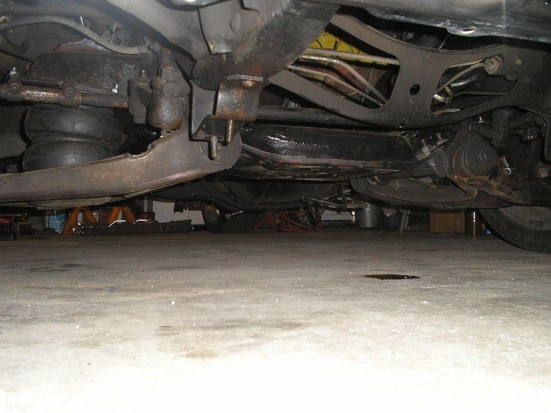

Well, you asked for pics, and I happen to have one of my buddys 86, err, 73. Lol. It's from the bottom, so its not great, but it will help a bit I'm sure.His crossmember is sectioned 1.5" which was the perfect amount. It lays flat on pretty large 20s. Like a 28" tall tire. Very few mods to the arms. The uppers were angle, the lowers are stock, but clearanced for the bag. And clearance for a bolt on the frame. One of the nuts on the u-bolt that holds the lower arm had to be turned down on the lathe otherwise it caught up with the steering. A jam nut could be used for this. Also the top of the arm above the bushign has to be cut down for the steering to complete its range of motion. With a 1" Z it would lay 22s. He still has about a 1/2" of upward travel when laid out.
