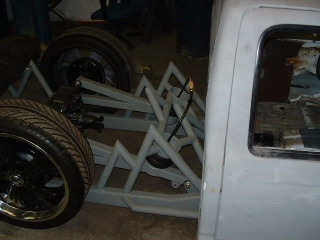

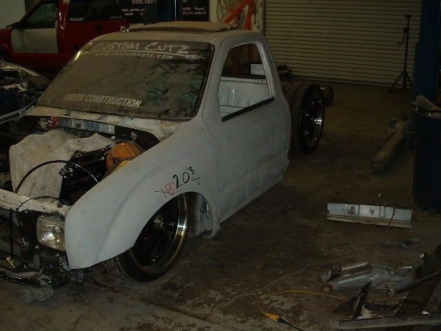

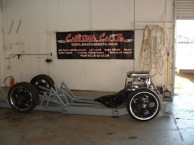

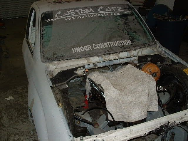

here are some pics of mineI HAD TO Z THE FRAME UP FRONT
drivensolow97
the back axle is a ford 8.5 that was shortened 5 inches
